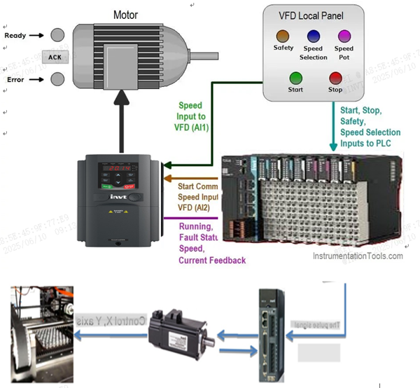

Configurations and protocals used in system device to device for operation:
VS-QE:
* PLC to HMI RS485 communication protocol used.
* Data can be read and write through HMI to the PLC.
* Operation process of machine can be monitored in HMI.
* System alarms and IO details can be monitored in HMI.
TS PLC:
•    Machine operation is controlled by the PLC, As per the logic written in the PLC.
•    Used ladder language for the sequencial logic development.
•    Servo is controlling through motion controller Ethercat mode.
•    PLC to VFD RS485 communication protocol used for data read and write. ON/OFF controlling through PLC digital input and output.
•    PLC input and command getting thriugh the operator panel.
DA200:
•    Servo Ethercat mode, which is controlled through PLC motion controller.
•    With this ethercat mode accuracy and response is high.
•    Ethercat mode hardware connection to PLC and servo are so simple and neat, using a ethernet cable for full control.
GD200A:
* Wall mounting done.
* Speed controlling through the RS485 communication.PLC to drive.
* ON/OFF controlled through PLC DI/DO.
* Drive running in 80% current at machine’s full load.

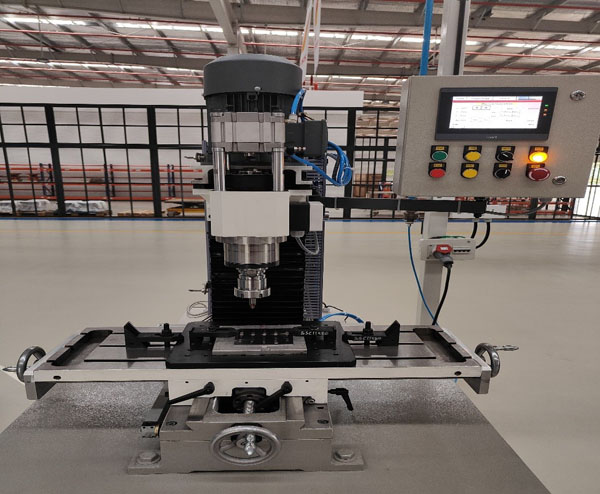

1. Project information:Table top drilling machine with servo position
Customer demand - The customer had to make controlled chamfer on drilled hole of an Aluminum components. The chamfer had controlled depth for rivet seating. The depth control on the chamfer had to be maintained within 30 microns for correct. The customer was using a hand operated drilling machine with mechanical dead stop. The depth control was very difficult in this setup and was set up time was.

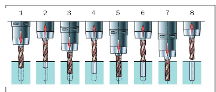

Solution - This now has been replaced by our machine which has a 1.5HP spindle with 500-2800 RPM stepless speed variation through VFD interface. The depth, feed and rapid return of the tool is by the servo motor coupled to ball screw. The touch screen HMI can be used to program the spindle speed, drill feed, rapid return and dwell.
Drilling positions and process

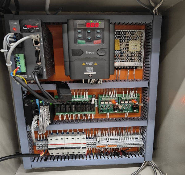

Control Panel
2. INVT solution
NOProductQty
1SV DA200-1R0-41
2TS635 PLC1
3VS07-QE 1
4VFD GD200A-2R2G-41
