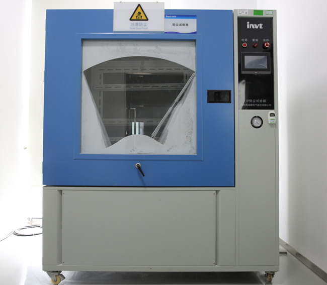

Generally, the dust test is conducted to verify the dust tightness of the product and protection against solid foreign objects to penetrate the equipment inside the enclosure.
The dust test is carried out by using a dust test chamber, which simulates the destruction of the natural wind and sand climate to the product, and is suitable for testing the sealing performance of the product enclosure. It is mainly used for IP5X and IP6X tests specified in Degrees of protection provide by enclosure. The working principle of the dust test chamber is that the fan drives a certain concentration of dust to blow across the surface of the specimen at a certain flow rate so as to test the ability of the specimen to defend against the penetrating effect of dust particles, the ability of blocking effect and the ability of storage and operation under the action of the dust-filled atmosphere. The equipment has an airflow carrying vertical circulation of dust, the bottom of the air duct is connected with the interface of the taper hopper, and the air inlet and outlet of the fan are directly connected with the air duct. Connect the diffuser to the duct in an appropriate position to form a closed vertical dust blowing circulation system which makes the air flow flows smoothly and disperses the dust. In addition, a VFD can be used to adjust the wind speed according to the needs of the test.

Test equipment:
Our company is equipped with dust test chambers special for IP5X and IP6X specified in GB/T 4208, and the test chambers can be heated up to 40 ℃ to reduce the relative humidity in the chambers. The HMIs, PLCs and VFDs used by the test chambers are developed by our company, and the operation interfaces and programs are developed and completed by our R & D personnel. Different from the distributed mechanical operation buttons of common dust test chambers, all interface displays and operations of our dust test chambers are integrated on HMIs to make the operation and monitoring more intelligent and convenient.
This test chamber can be used to verify VFDs, automotive electronic products, or PV-related outdoor products or indoor installation products suffering from dust seriously. Air duct verification can also be conducted for some products of low protection degrees.

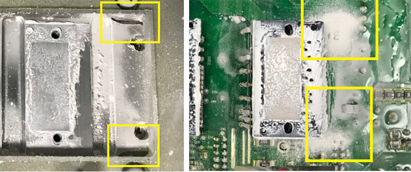

1. Air duct independence: Some specimens with protection degrees of IP20 cannot block dust from entering the machine interior, but they can reduce the amount of dust injected into the machine from the air duct through early-stage design and later-stage verification.
Through the dust test, we can clearly observe in which channel and what way dust accumulates, what parts or devices dust accumulates on, and the degree of dust accumulation. Through mastering this information, we can continuously optimize our products so as to enhance product competitiveness.
Gap between the radiator and air duct                Dust gathered on the device through the gap

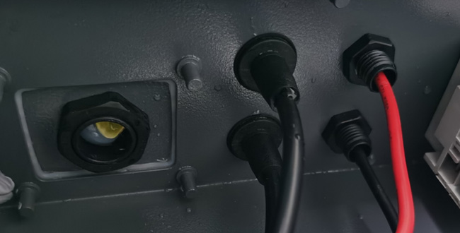

2. Verification of protection degree: For specimens with protection degrees of IP5X or IP6X, we usually observe the protection conditions of sealing strips, cable interfaces and radiator gaps to judge whether the products meet the design index.
Verify whether dust enters into product interface gaps
