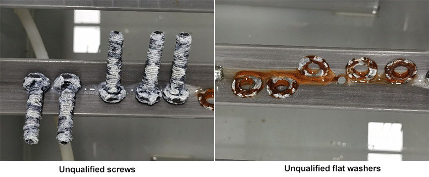

1. Metal structural parts: Perform the incoming inspection for commonly used screws, terminal blocks, copper bars, and connectors to evaluate whether they meet the product operating requirements, and to screen unqualified samples intuitively and quickly.
