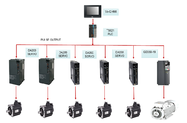

2.2 INVT Solution
Product
Model no.
Qty
Application
HMI
VS070QE
Operator Display
PLC
TS621
Controller
PLC
FL1002
Input Expansion
PLC
FL2002
Output Expansion
VFD
GD350-19-110G-4-B
Pilger Mill
SERVO
SV-DA200-5R5-4-S0/ SV-MM18-5R5B-4-1A0-1000
Straightening/Feeder
SERVO
SV-DA200-7R5-4-S0/ SV-MM18-7R5B-4-1A0-1000
Straightening
SERVO
SV-DA200-011-4-S0/ SV-MH20-011B-4-1A0-1000
Straightening

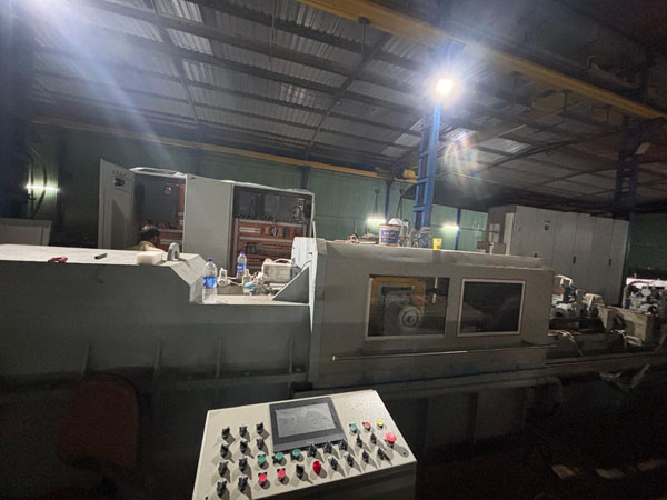

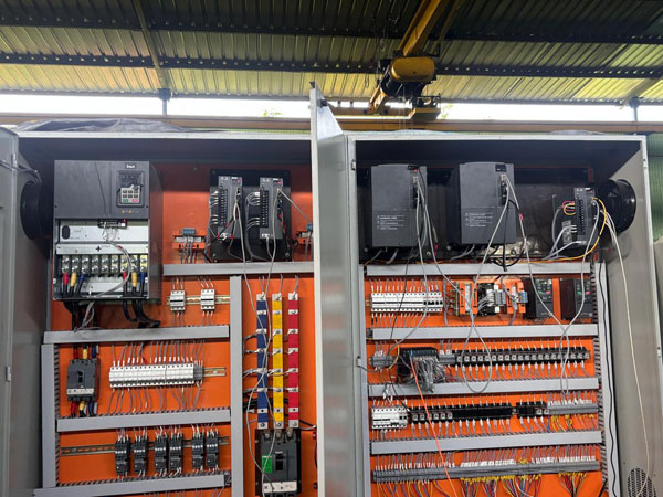

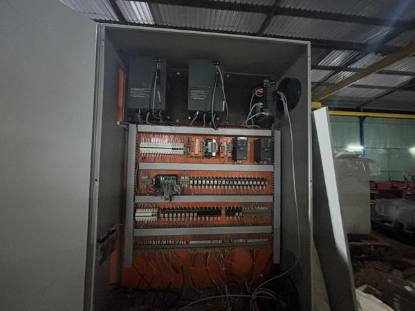

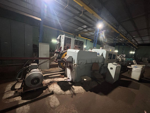

3. System Commissioning
Control panels

a. TS621 high performance PLC is used to synchronize the feeding servo and straightening rotary axis which leads to increase the productivity.
b. Two Feeding servo used so that if one servo reach to end limit other can feed it leads to uninterrupted feeding of pipe.
c. GD350-19 used to rotate the main cold pilger application which is efficiently gives torque maintain the RPM during process.
d. Low maintenance and Auto synchronization due to servo system
