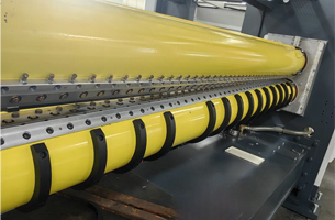

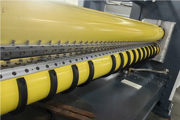

1. Project Background
1. Large cutting width and high motor power make single-motor drive impractical, requiring multiple motors for counter-drive
2. High demands for cutting precision and speed necessitate specialized algorithmic electronic cams
3. Significant vibration at the cross-cutting station and large fluctuations in the spindle encoder result in low cross-cutting accuracy
To address these challenges, the company decided to implement the INVT system solution, aiming to achieve an efficient and intelligent upgrade of the cross-cutting machine.

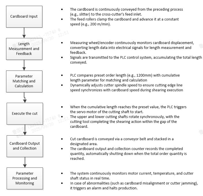

2. Equipment Principle
The cross-cutting machine achieves precise cutting through the coordinated operation of mechanical transmission and electronic control systems. Its core principles include:
* Paper Feeding and Measurement:
The feed rollers drive the cardboard to move at a constant speed. The measuring wheel (or encoder) monitors the cardboard displacement in real time, converting the length signal into an electrical signal that is fed back to the control system.
* Knife Shaft Drive:
The upper and lower knife shafts are driven by servo motors, achieving synchronized rotation via gears or synchronous belts. The linear speed of the knife shafts must precisely match the cardboard's movement speed to ensure clean, straight cuts.
* Cutting Execution:
When the cardboard reaches the preset length, the control system triggers the blade shaft to rotate. The blade completes the cutting action within the synchronized angle, after which the shaft resets to await the next cut.

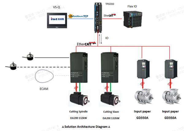

3.3 System Architecture:
The Invt system solution employs advanced TP series motion controllers, DA200 EtherCAT bus servo drives, Flex series I/O, GD350A series inverters, and VS-Q series touchscreens. Features such as high-power dual servo drive systems, power balancing technology, and built-in cross-cutting electronic cams enhance cutting precision and efficiency while minimizing paper waste.
