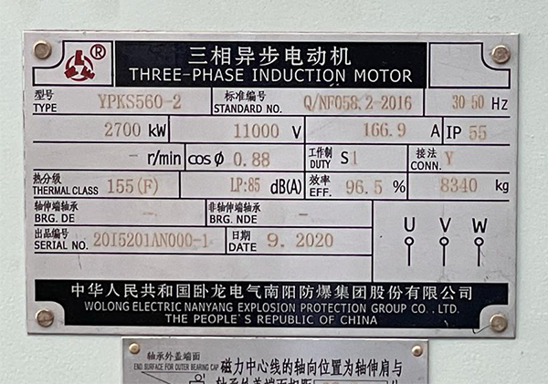

2.1 Motor introduction.
Detailed motor parameters are list as follow:
Table 1.Main fan motor Parameters
Motor Model
Power
Rated Voltage
Rated Current
Rated Speed
Power Factor
Load Type
YPKS560-2
2700 KW
11000 V
166.9 A
2990 RPM
0.88
Main fan
Figure 2.Themain fan motor nameplate
