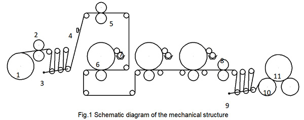

1 The working principle and introduction of woven bag chromatic flexographic printing machine
1.1 The whole equipment
The parts of the woven bag chromatic flexographic printing machine include: unwinding frame, unwinding roller, material buffer mechanism, color mark sensor, front traction roller, printing roller, ink transfer roller, rear traction roller, hoard material buffer mechanism, winding roller, finished product

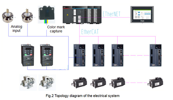

This solution adopts AX70 medium PLC, DA200 servo system, VS HMI, GD20 VFD full set of INVT electrical products. The AX70 PLC and servo are controlled synchronously via the EtherCAT high-speed bus. AX70 PLC and touch screen through Ethernet communication, 100M high-speed communication speed makes the touch screen interaction more smooth. The frequency of VFD is controlled by the analog output port of the servo drive which is modified by AX PLC via communication, which improves the frequency response speed of the VFD and saves electrical costs.
2.2 System topology diagram

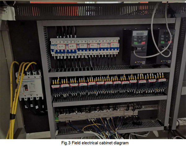

2.4 Field electrical cabinet diagram

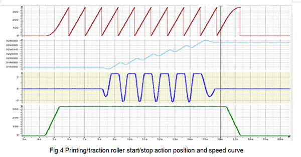

The previous printing system, using a single cam curve to plan different incoming material lengths and printing plate lengths, can only perform cam meshing in the state where the printing roller is stopped. Due to the limitations of the printing machine characteristics: First, the mechanical inertia of the roller is large, and it can only be slowly accelerated from 0 speed to the production speed. Second, the woven bag is a large tensile elastic material, which will have different position offsets at different speeds. The printing deviation between the acceleration section and the deceleration section is too large, resulting in waste films and waste of printing materials.
Now with the synchronous control function of INVT AX70 medium PLC cam, the printing roller and the woven bag can always be at the same production speed during the printing process, avoiding the printing deviation in the acceleration and deceleration section, and the full chromatic deviation of <0.8mm at a maximum production speed of 120 m/min.
After the printing roller enters the production speed and rotates 3 times to ink, the traction runs to accelerate the cam, directly accelerating to the production speed and printing simultaneously. When the deceleration is stopped, the traction runs the deceleration cam and directly disengages the printing. The printing roller then slows down again and stops. As shown in figure 4.

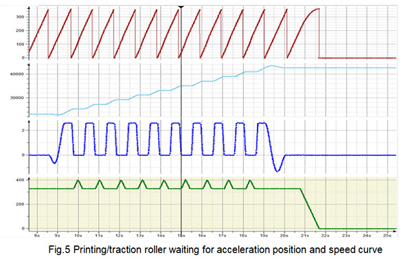

3.2Traction waiting section printing roller acceleration function
The printing roller is accelerated during the traction stop waiting phase, which speeds up the overall operation of the equipment without affecting the printing effect. At the same printing synchronization speed, the production speed can be increased by up to 30%.

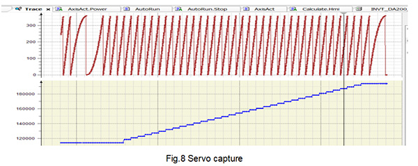

3.4Color mark servo DI capture function
The color mark capture adopts the servo-driven internal interrupt to grasp the encoder position, which has the advantages of high accuracy, the color mark is not easy to lose the standard, and the color mark alignment is grasped by the servo-driven internal interrupt to grasp the encoder position. In the case of a charging speed of 100 m/min, the bench marking accuracy reaches 0.15mm, and if there are multiple color mark grabbing signals in the color mark window, all the grasping positions will be compared and the grasping position with the smallest deviation will be selected. It has the characteristics of position deviation does not accumulate, and it is not afraid of individual color standard damage.
