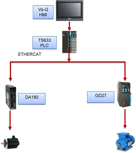

Solution Topology:

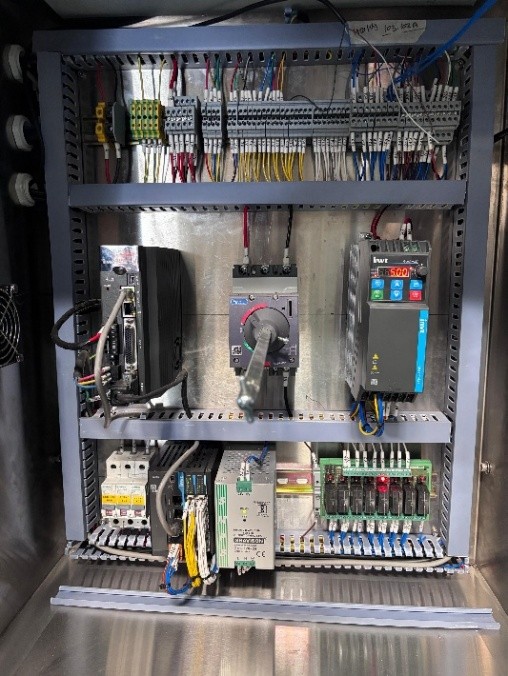

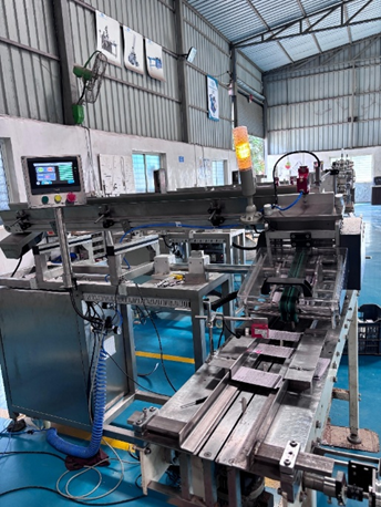

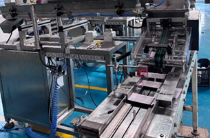

System commissioning
Control panels
