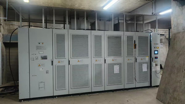

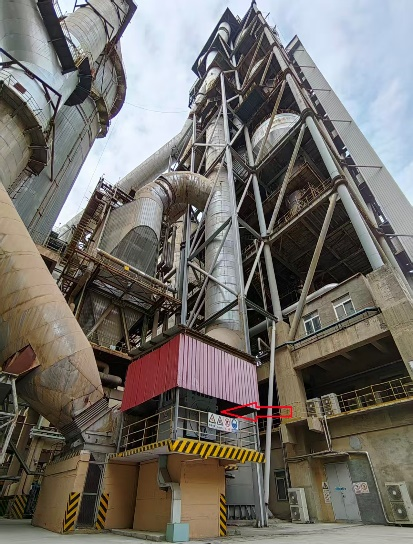

Abstract: Recently, during the retrofitting of a 6,500t/d clinker production line at a major cement group, GD5000-4000KVA Medium-voltage variable frequency drive successfully powered a 2,500kW high-temperature fan, achieving stable commissioning. This marks another significant breakthrough for domestically produced high-end variable frequency drives in applications with industry benchmark clients, establishing their reliable position in critical process operations.

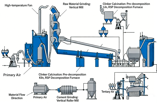

In the production of cement using the new dry process, the high-temperature fan serves not only as the system's power source but also as the central hub for ensuring stable kiln operation and energy-saving control. Its operational reliability directly impacts the continuity and efficiency of the entire production line. Against this backdrop, the client has imposed near-rigorous requirements on the drive equipment—demanding ‘zero unplanned downtime’ throughout an entire maintenance cycle. This represents not merely a technical challenge but a comprehensive test of the product's long-term stability and service capability.
INVT Solution

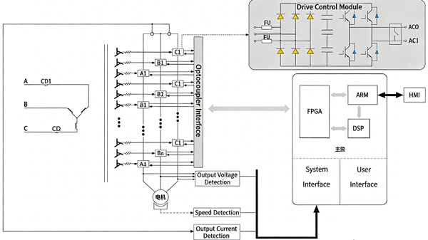

This high-temperature fan is responsible for extracting waste gases at nearly 400°C, characterized by high temperatures and high dust content, from the entire firing system. Process requirements mandate real-time, precise adjustment of airflow volume based on kiln conditions to stabilize system negative pressure, temperature, and material flow. To meet the project's demands for extreme operating conditions, the INVT GD5000 series medium-voltage VFD was selected. This product, optimized and upgraded from a mature platform, has undergone extensive market validation and offers high reliability.
The solution employs a dual-redundancy design utilizing both Profibus DP communication and hard-wired terminal control. Under normal conditions, comprehensive data monitoring and precise control are achieved via the fieldbus. Should communication fail, the system seamlessly switches to the backup hard-wired control mode, ensuring maximum continuity of operation.
Furthermore, addressing the scenario where the fan is already rotating at low speed due to duct pressure prior to start-up, the variable frequency drive activates its speed tracking restart function. This enables a smooth, low-impact start-up, effectively protecting both the motor and mechanical systems.

2. Precise process control: High-performance spatial voltage vector control technology ensures accurate and rapid airflow regulation, robustly supporting thermal stability within the kiln system while enhancing clinker yield and quality.
