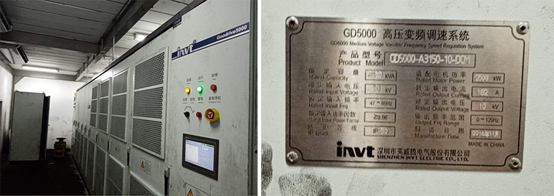

According to customer demand, the VFD consists of gear switch cabinet, transformer cabinet, power cell cabinet and control cabinet with PG card. The GD5000 VFD has function of local/remote button and emergency stop button on control cabinet.

Main systme diagram:
Figure 2.The system diagram
Figure 3.The internal mixer
Figure 4.The internal mixer VFD
