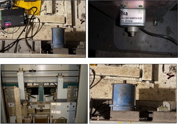

The customer operating an international brand elevator door system required a reliable replacement for the existing door controller due to recurring door faults and aging electronic components. The key requirement was to retain the original asynchronous (AM) door motor and existing encoder while upgrading the control system in order to improve operational stability, reduce downtime, and simplify commissioning at site.
Challenges
  • Integration of the EC30 door controller with a proprietary elevator door mechanism
  • Ensuring compatibility with the existing asynchronous (AM) door motor
  • Achieving stable operation using the existing encoder feedback, including encoder matching and signal optimization
  • Ensuring smooth and accurate door operation without the use of mechanical limit switches
  • Reducing commissioning time while minimizing long-term maintenance complexity
INVT Solutions
  • Deployment of INVT EC30 Door Drive
  • Reuse of Otis AM door motor and original encoder
  • Closed-loop control using encoder feedback for precise door positioning
  • Auto speed curve generation and self-learning functions
  • One-button debugging for quick commissioning
  • Intelligent obstacle detection and fault monitoring
This approach eliminated the need for motor or encoder replacement, reducing cost and installation time.

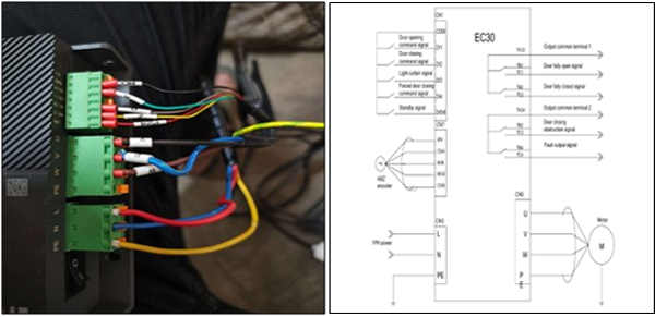

Door drive terminals details:
TerminalFunction
PE, N, LSingle phase supply to door Drive
PE, U, V, WDoor Motor Supply
+24V, GND, CS/A, MI/B, MO/ZEncoder connection
CN1.1- COMDoor drive COM
DI1Door Open signal
DI2Door close signal
DI3Door sensor signal
TA12Door limit com signal
TC1Door Open Limit (NO)
TB1Door Open Limit (NC)
TC2Door Close Limit (NO)
TB2Door Close Limit (NC)
TA34Output com Relay-2
TB3(NC)/TC3(NO)Door closing obstruction signal
TB4(NC)/TC4(NO)Fault output
Application wiring diagram:
System commissioning:
Fig. Door Drive and Motor
Result
  • Smooth and precise door movement
  • Stable operation with existing AM motor and encoder
  • Significant reduction in door faults
  • Commissioning time reduced by more than 50%
  • No mechanical modifications required to Above system.
