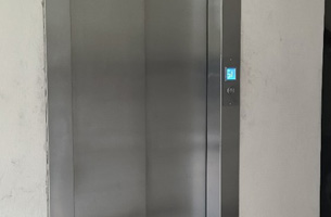

For the good appearance, LCD display is needed for the LOP system. And arrival gong and arrival light system is useful in the group control project. For the in-car display, we are using the LM21 7inch 64 color TFT displays, which support the customized background photo and sounds.
LOP and COP

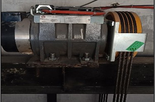

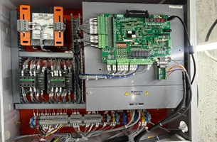

Control cabinet is simple since it base on the EC100 integrated controller which combine the motor drive and the elevator controller. For the traction motor, gearless motor is more efficiently and high performance for the passenger elevators.
Control cabinet and Traction motor

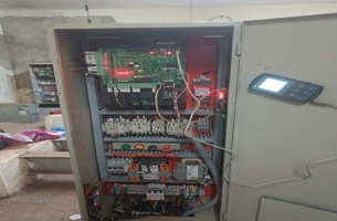

EC100 integrated elevator controller provides the easy debugging way for the group control system setting. With the EC-PAD handheld operator connecting to the MC-GCL group control board, we can check the group control parameters and finish the debugging in a short time.
