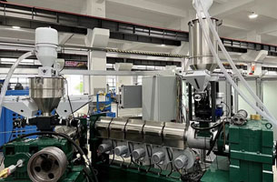

The high-speed continuous roll bag making machine is suitable for producing all kinds of plastic film fresh-keeping bags of different sizes and thicknesses. The bag making machine integrates mechanical, electrical, optical, and pneumatic, highly mechanized and automated equipment. As shown in the figure below, the bag making machine is running automatically at high speed.
 Figure 1:bag making machine
With the rapid development of the packaging industry, more and more manufacturers hope to enhance product competitiveness by improving the production efficiency of bag making machines. With the increasing demand for multi-variety and high-quality packaging bags, customers have put forward higher requirements for the control system of the bag making machine. In view of the fact that the original control system of the bag making machine cannot meet the high efficiency requirements of the new process, INVT introduced high-speed continuous rolls bag making machine control system. The system adopts INVT medium-sized PLC system integration products, and integrates application development through the overall system packaging method. The normal working efficiency of the equipment is 250 units/min, and the fastest is as high as 280 units/min.
