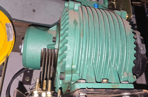

Figure 2.3 The host and control cabinet before the transformation
