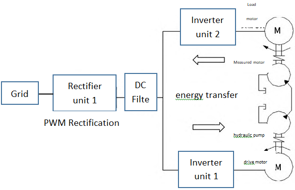

This is the first high-power energy-feedback hydraulic motor loading test system developed by a well-known domestic manufacturer of hydraulic components and systems. It is used for the development, testing, and technical application of hydraulic systems within the company. During operation, the drive motor rotates the hydraulic pump through a coupling. The motor under test is driven by the hydraulic pump and is connected to the load motor via a coupling. The load motor provides the required load torque to the motor under test, thus enabling the motor loading test.
Compared to traditional motor loading test systems, the energy-feedback loading system is an optimal solution for hydraulic motor loading tests. This system features fast response speed and high energy efficiency. During testing, the majority of the mechanical energy consumed by the load can be fed back into the power grid through the VFD, thus achieving energy-saving testing. The active rectification feedback unit that operates in four quadrants not only eliminates higher-order harmonics and improves the power factor but is also unaffected by grid fluctuations. This makes it especially suitable for integrated test benches for hydraulic pump and motor testing.

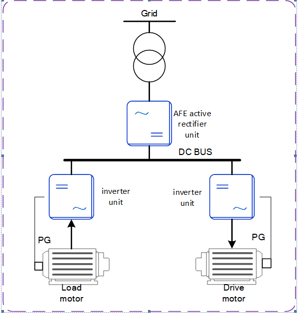

Schematic diagram of energy-feedback loading system

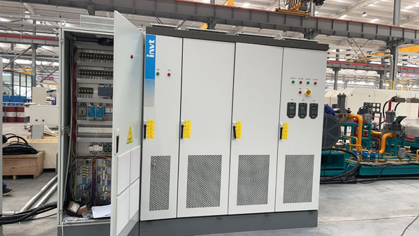

According to the test bench control requirements, INVT provides a complete solution for the four-quadrant frequency conversion cabinet, using the GD880 series engineering drive products. The solution integrates an incoming cabinet, active rectifier cabinet, inverter cabinet, and control cabinet. The products are modularly designed based on the DFX (Design for Excellence) concept, employing advanced control algorithms, and offer excellent speed and torque control performance. The topology and cabinet layout are as follows:
System Topology

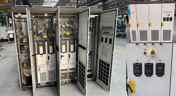

 Cabinet Layout
Incoming Cabinet: Includes incoming protection circuit breaker, power-up buffering components, and power supply module.
Rectifier Cabinet: Includes active rectifier unit, LCL filter unit, fast fuse, and DC busbar.
Inverter Cabinet: Includes inverter unit, output reactor, fast fuse, and common-mode filter.
Control Cabinet: Includes active rectifier control box, inverter control box, operation panel, and auxiliary control circuits, etc.
