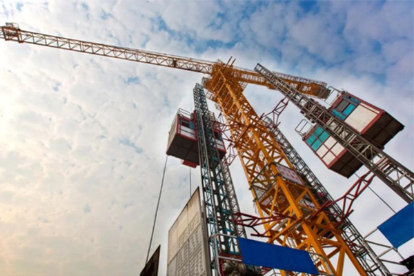

In the construction machinery industry, construction lifts are essential construction equipment in modern high-rise construction. With the development of our country's economy, a large number of large-scale buildings have been constructed, which has prompted the increasing use of construction elevators. In recent years, various high-altitude working accidents have continued to escalate, and there has been increasing concern about the safety of construction lifts.
